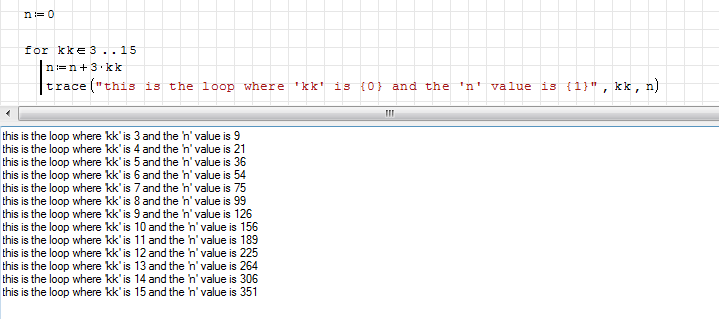

The menu option "View > Output Window" opens up an output window at the bottom of the page. What is the purpose of the Output Window? Anyone has an example of using the "Output Window" in SMath Studio?

The output window show the output of the trace(...) function
output window
here is the file of the example: output window.zip
The trace function was added in SMath 0.91

Thanks very much. I haven't used the "trace" function yet. Now it all makes sense.

I think that trace() it's a very powerful debugging tool Good

new wiki pages added for trace and Output window
